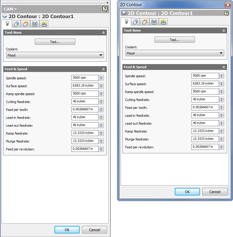

Normally, the Operation dialog box shares the same space as the CAM Browser. You can separate the Operation dialog from the CAM Browser so that it can float freely or be docked to a more convenient location by doing the following:
Manage panel
Options
. The CAM Options dialog box is displayed. The next time a machining strategy is selected, the Operation dialog box will display independent of the CAM Browser.
At the left, the Operation dialog box shares the same space as the CAM Browser. At the right, it is shown separated from the CAM Browser in a floating state.

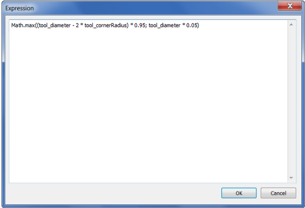

As far as possible, Inventor HSM Pro provides working default values for each of the strategy parameters found in the Operation dialog box. You can control the default values of each parameter by right-clicking over the parameter name to display the pop-up context menu shown below.
The current parameter name (in bold) is displayed at the top of the pop-up context menu. The remaining menu items offer the following options:
The Expression dialog box

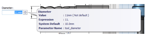

The names for referencing other parameters can be determined by holding down the Shift key while hovering your mouse over a parameter field.
Parameter names are shown in the tooltip when holding Shift
