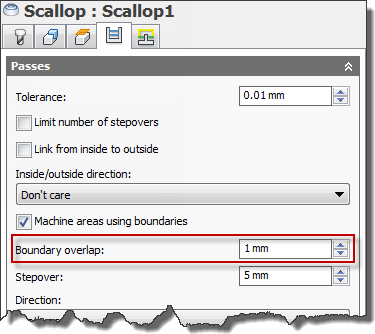

When using slope confinement and/or rest machining for a Scallop operation, you can use the Machine areas using boundaries setting on the Passes tab to start offsetting the toolpath from the boundaries created by the slope and/or rest material detection.
You can specify a boundary overlap so the boundary of the detected slope range or rest area is extended by the specified overlap amount.
The Boundary Overlap setting
