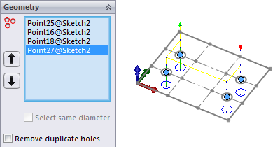

For drilling, you can machine anything that is selectable as a point. You can select the points individually, by clicking on the model from within the Drill operations dialog.
Selecting individual points as drill geometry

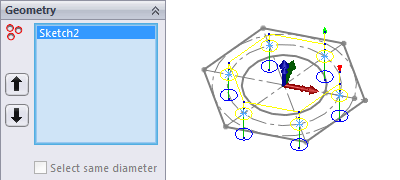

This sketch can then be selected directly as the geometry in the Drill operations dialog.
Selecting a sketch as drill geometry
