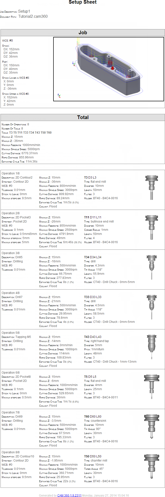

Most setup sheets have common settings which can be used to adjust their behavior. The settings can be made in the Post Process dialog box. For instance, you can set the tool change time in seconds by setting toolChangeTime in the lower-right property list when selecting the HTML Setup Sheet called setup-sheet.cps.
Example setup sheet
