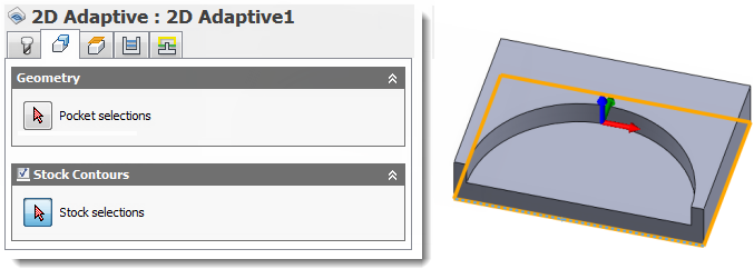

  2. On the Geometry tab, select the stock contour.
    Selecting the stock contour

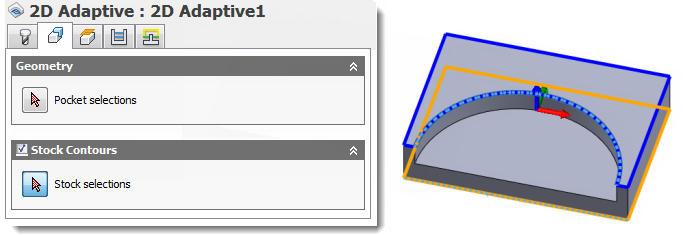

  3. Next, select the contour with the open pocket.
    Selecting the contour with the open pocket
