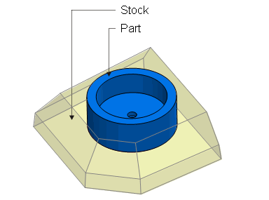

Adaptive Clearing supports stock definitions of any shape.
Irregular stock

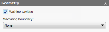

  3. Open the Adaptive Clearing parameters and set the machining boundary to None.
    No machining boundary
