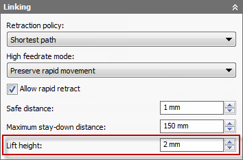

Some of the machining strategies in Inventor HSM Pro perform stay-down movements when transitioning between cutting toolpaths. These transitions are done at the same Z-level as the cutting passes. By setting Lift height, you can move the tool away from the stock during the transitions. Lifting the tool helps to avoid witness marks and allows higher feedrates.
The Lift height setting is available for the 2D and 3D Pocket, Adaptive Clearing, and Horizontal Clearing strategies on the Linking tab.
