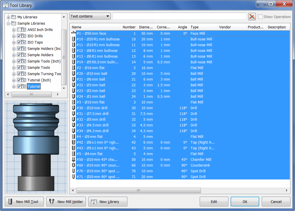

  1. Select some tools that you want to edit.
    Selecting tools to copy
  2. Copy these to the clipboard by right-clicking and selecting Copy, or by pressing Ctrl+C.

  7. In the Tool Library dialog box, right-click and select Paste, or press Ctrl+V. The tools from the clipboard are added to the current library, but will not replace existing tools. If you want to replace tools, you need to delete them first.
