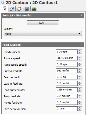

The type of coolant used with the tool.
The rotational speed of the spindle.
The spindle speed expressed as the speed of the tool on the surface.
The rotational speed of the spindle when performing ramp movements.
Feed used in cutting moves.
The cutting feedrate expressed as the feed per tooth.
Feed used when leading in to a cutting move.
Feed used when leading out from a cutting move.
Feed used when doing helical ramps into stock.
Feed used when plunging into stock.
The plunge feedrate expressed as the feed per revolution.

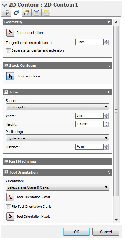

Specifies the distance to extend the open contours tangentially.
No Tangential extension
10 mm Tangential extension
Enable to enter a tangential end extension distance value.
Specifies the distance to extend the open contours tangentially at the end.
Enable to specify the perimeter of the stock that needs to be faced.
You can add tabs to the 2D Contour toolpath to hold the workpiece securely while all other material is machined away. Tabs are very useful when cutting thin plastic or wood materials using 2D routers.
Rectangular tabs
Triangular tabs
Limits the operation to just remove material that a previous tool or operation could not remove.
Rest Machining ON
Rest Machining OFF
Specifies the diameter of the rest material tool.
Specifies the corner radius of the rest material tool.
Specifies how the tool orientation is determined using a combination of triad orientation and origin options.
The Orientation drop-down menu provides the following options to set the orientation of the X, Y, and Z triad axes:
The Origin drop-down menu offers the following options for locating the triad origin:

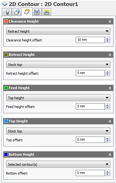

The Clearance height is the first height the tool rapids to on its way to the start of the tool path.
Clearance Height
The Clearance height offset is applied and is relative to the Clearance height mode selection in the above drop-down list.
Retract height mode sets the height that the tool moves up to before the next cutting pass. Retract height mode should be set above the Feed height and Top. Retract height mode is used together with the subsequent offset to establish the height.
Retract Height
Retract height offset is applied and is relative to the Retract height mode selection in the above drop-down list.
Feed height mode sets the height that the tool rapids to before changing to the feed/plunge rate to enter the part. Feed height mode should be set above the Top. A drilling operation uses this height as the initial feed height and the retract peck height. Feed height mode is used together with the subsequent offset to establish the height.
Feed Height
Feed height offset is applied and is relative to the Feed height mode selection in the above drop-down list.
Top height mode sets the height that describes the top of the cut. Top height mode should be set above the Bottom. Top height mode is used together with the subsequent offset to establish the height.
Top Height
Top offset is applied and is relative to the Top height mode selection in the above drop-down list.
Bottom height mode determines the final machining height/depth and the lowest depth that the tool descends into the stock. Bottom height mode needs to be set below the Top. Bottom height mode is used together with the subsequent offset to establish the height.
Bottom Height
Bottom offset is applied and is relative to the Bottom height mode selection in the above drop-down list.

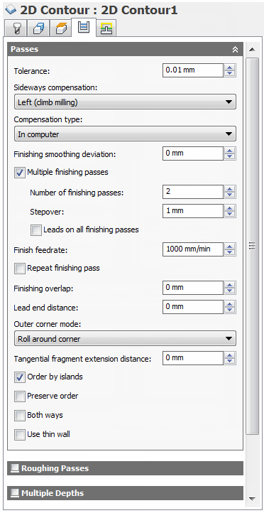

Data starving occurs when the control becomes so overwhelmed with data that it cannot keep up. CNC controls can only process a finite number of lines of code (blocks) per second. That can be as few as 40 blocks/second on older machines and 1,000 blocks/second or more on a newer machine like the Haas Automation control. Short line moves and high feedrates can force the processing rate beyond what the control can handle. When that happens, the machine must pause after each move and wait for the next servo command from the control.

The maximum amount of smoothing applied to the finishing passes. Use this parameter to avoid sharp corners in the toolpath. Setting this parameter leaves more stock than requested at the contour corners.
Enable to perform multiple finishing passes.
Specifies the number of finishing passes.
Shown with three finishing passes
The maximum distance between finishing passes.
Forces a full lead in and out on every finishing pass.
Enabled
Disabled
Feedrate used for the final finishing pass.
Enable to perform the final finishing pass twice to remove stock left due to tool deflection.
The finishing overlap is the distance that the tool passes beyond the entry point before leading out. Specifying a finishing overlap ensures that the material at the entry point is properly cleared.
No finishing overlap
0.25" finishing overlap
Specifies the distance the lead-out feed rate begins before the end of the selected geometry.
@ 0"
@ .5"
When machining outer corners, it may be necessary to avoid rolling around the corner in order to leave the corner perfectly sharp.
The Outer corner mode setting lets you machine outer corners in three different ways.
Specifies in which order the depth cuts are taken when there are multiple profiles.
Disabled
Disabled - Depth cuts are ordered by depth.
Enabled
Enabled - Depth cuts are ordered by profile.
Specifies that features are machined in the order in which they were selected. When unselected, Inventor HSM Pro optimizes the cut order.
Specifies that the operation will use both Climb and Conventional milling to machine open profiles.

When milling part features with wall thicknesses comparable to sheet metal stock, or even thinner, the stock is subjected to the forces generated by metal removal. This can result in the delicate structure of thin walls moving relative to the tool, making it difficult to maintain dimensional accuracy and impart the specified surface finish.
This option can be used to reduce the vibration and chatter by ensuring that both sides of a thin wall are machined at the same time.
The width of walls that should be considered thin walls.
Any wall with this width (or thinner) is machined on both sides at the same time to reduce vibration and chatter.

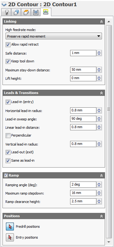

Specifies when rapid movements should be output as true rapids (G0) and when they should be output as high feedrate movements (G1).
This parameter is usually set to avoid collisions at rapids on machines which perform "dog-leg" movements at rapid.
The feedrate to use for rapid movements output as G1 instead of G0.
When enabled, retracts are done as rapid movements (G0). Disable to force retracts at lead-out feedrate.
Minimum distance between the tool and the part surfaces during retract moves. The distance is measured after stock to leave has been applied, so if a negative stock to leave is used, special care should be taken to ensure that safe distance is large enough to prevent any collisions.
When enabled, the strategy avoids retracting when the distance to the next area is below the specified stay-down distance.
Specifies the maximum distance allowed for stay-down moves.
1" Maximum stay-down
2" Maximum stay-down distance
Specifies the lift distance during repositioning moves.
Lift height 0
Lift height .1 in
Enable to generate a lead-in.
Lead-in
Specifies the radius for horizontal lead-in moves.
Horizontal lead-in radius
Specifies the sweep of the lead-in arc.
Sweep angle @ 90 degrees
Sweep angle @ 45 degrees
Specifies the length of the linear lead-in move for which to activate radius compensation in the controller.
Linear lead-in distance
Replaces tangential extensions of lead-in/lead-out arcs with a move perpendicular to the arc.
Shown with Perpendicular entry/exit
Example: A bore with lead arcs that are as large as possible (the larger the arc the less chance of dwell mark), and where a tangent linear lead is not possible because it would extend into the side of the bore.
The radius of the vertical arc smoothing the entry move as it goes from the entry move to the toolpath itself.
Vertical lead-in radius
Enable to generate a lead-out.
Lead-out
Specifies that the lead-out definition should be identical to the lead-in definition.
Specifies the length of the linear lead-out move for which to deactivate radius compensation in the controller.
Linear lead-out distance
Specifies the radius for horizontal lead-out moves.
Horizontal lead-out radius
Specifies the radius of the vertical lead-out.
Vertical lead-out radius
Specifies the sweep of the lead-out arc.
Example: A bore with lead arcs that are as large as possible (the larger the arc the less chance of dwell mark),and where a tangent linear lead is not possible because it would extend into the side of the bore.
Enable ramps.
Shown with a 15 degree Ramping angle
Specifies the maximum ramping angle.
Specifies the maximum stepdown per revolution on the ramping profile. This parameter allows the tool load to be constrained when doing full-width cuts during ramping.
Height of ramp over the current stock level.
Specifies the helical ramp diameter.
Specifies the minimum ramp diameter.
Selection button to choose predrill positions.
Selection button to choose entry positions.
