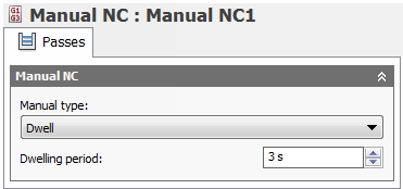

Then select Manual NC from the menu, and choose the appropriate type of NC entry from the Manual type: drop-down menu.
Editing two types of Manual NC entries: Comment and Dwell
