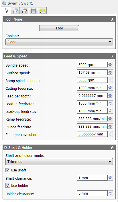

The type of coolant used with the tool.
The rotational speed of the spindle.
The spindle speed expressed as the speed of the tool on the surface.
The rotational speed of the spindle when performing ramp movements.
Feed used in cutting moves.
The cutting feedrate expressed as the feed per tooth.
Feed used when leading in to a cutting move.
Feed used when leading out from a cutting move.
Feed used when doing helical ramps into stock.
Feed used when plunging into stock.
The plunge feedrate expressed as the feed per revolution.
When using a tool with a holder, you can choose between one of five different shaft and holder modes, depending on the machining strategy. Collision handling can be done for both the tool shaft and holder, and they can be given separate clearances.
Disabled
Pull away
Trimmed
Detect tool length
Specifies that the shaft of the selected tool will be used in the toolpath calculation to avoid collisions.
The tool shaft always stays this distance from the part.
Specifies that the holder of the selected tool will be used in the toolpath calculation to avoid collisions.
The tool holder always stays this distance from the part.

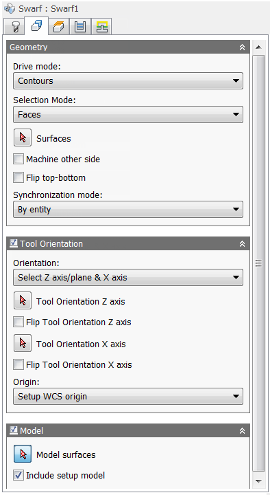

Machining from contours only or from surfaces are both supported. Choose Contours or Surfaces from the drop-down menu.
Selection button to choose the surfaces to be machined.
Selecting Contours from the Drive mode: drop-down menu provides the following synchronization options:
Specifies how the tool orientation is to be determined using a combination of triad orientation and origin options.
The Orientation drop-down menu provides the following options to set the orientation of the X, Y, and Z triad axes:
The Origin drop-down menu offers the following options for locating the triad origin:
Enable to override the model geometry (surfaces/bodies) defined in the setup.
Enabled by default, the model selected in the setup is included in addition to the model surfaces selected in the operation. If you disable this check box, then the toolpath is generated only on the surfaces selected in the operation.

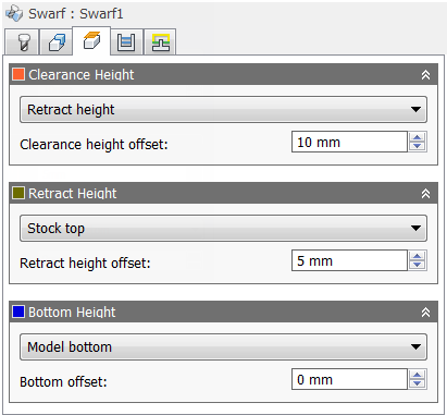

The Clearance height is the first height the tool rapids to on its way to the start of the tool path.
Clearance Height
The Clearance height offset is applied and is relative to the Clearance height mode selection in the above drop-down list.
Retract height mode sets the height that the tool moves up to before the next cutting pass. Retract height mode should be set above the Feed height and Top. Retract height mode is used together with the subsequent offset to establish the height.
Retract Height
Retract height offset is applied and is relative to the Retract height mode selection in the above drop-down list.
Bottom height mode determines the final machining height/depth and the lowest depth that the tool descends into the stock. Bottom height mode needs to be set below the Top. Bottom height mode is used together with the subsequent offset to establish the height.
Bottom Height
Bottom offset is applied and is relative to the Bottom height mode selection in the above drop-down list.

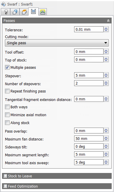

The cutting mode specifies how to machine down the sides.
Single pass
From bottom
Trim from bottom
From top
Trim from top
Spiral
Morph
Specifies an extra offset along the tool axis relative to the bottom guide curve.
Specifies the overall thickness of the stock.
Enable to enter a stepover value.
Specifies the horizontal stepover between passes. By default, this value is 95% of the cutter diameter less the tool corner radius.
Horizontal stepover
The number of roughing steps.
Enable to perform the final finishing pass twice to remove stock left due to tool deflection.
Specifies the tangential extension of the passes.
Specifies that the operation uses both Climb and Conventional milling to machine open profiles.
Unselected
Selected
Specifies the distance to extend machining for a closed pass.
Specifies the maximum distance over which to fan the tool axis.
Specifies the number of degrees the tool should be tilted sideways.
Specifies the maximum length of a single segment for the generated toolpath.
Specifies the maximum angle change in a single tool axis sweep for the generated toolpath.

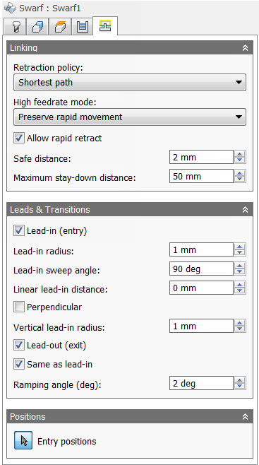

Controls how the tool moves between cutting passes. The following images are shown using the Flow strategy.
For CNC machines that do not support linearized rapid moves, the post processor can be modified to convert all G0 moves to high-feed G1 moves. Contact technical support for more information or instructions how to modify post processors as described.
Specifies when rapid movements should be output as true rapids (G0) and when they should be output as high feedrate movements (G1).
This parameter is usually set to avoid collisions at rapids on machines which perform "dog-leg" movements at rapid.
The feedrate to use for rapids movements output as G1 instead of G0.
When enabled, retracts are done as rapid movements (G0). Disable to force retracts at lead-out feedrate.
Minimum distance between the tool and the part surfaces during retract moves. The distance is measured after stock to leave has been applied, so if a negative stock to leave is used, special care should be taken to ensure that safe distance is large enough to prevent any collisions.
Specifies the maximum distance allowed for stay-down moves.
1" Maximum stay-down distance
2" Maximum stay-down distance
Enable to generate a lead-in.
Lead-in
Specifies the radius for lead-in moves.
Lead-in radius
The radius of the vertical arc smoothing the entry move as it goes from the entry move to the toolpath itself.
Vertical lead-in radius
Specifies the sweep of the lead-in arc.
Sweep angle @ 90 degrees
Sweep angle @ 45 degrees
Specifies the length of the linear lead-in move for which to activate radius compensation in the controller.
Linear lead-in distance
Replaces tangential extensions of lead-in/lead-out arcs with a move perpendicular to the arc.
Shown with Perpendicular entry/exit
Example: A bore that has lead arcs that are as large as possible (the larger the arc the less chance of dwell mark), and where a tangent linear lead is not possible because it would extend into the side of the bore.
Enable to generate a lead-out.
Lead-out
Specifies that the lead-out definition should be identical to the lead-in definition.
Specifies the length of the linear lead-out move for which to deactivate radius compensation in the controller.
Linear lead-out distance
Specifies the radius for lead-out moves.
Lead-out radius
Specifies the radius of the vertical lead-out.
Vertical lead-out radius
Specifies the sweep of the lead-out arc.
Specifies the maximum ramping angle.
Selection button to choose entry positions.
