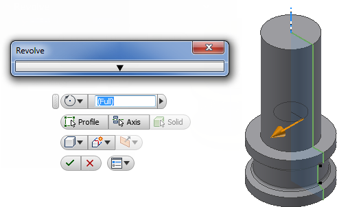

  1. Create a new Inventor part.
  2. Create a sketch with a single closed profile that represents the cross-section of the tool.
  3. Use the Revolve command to create a revolved feature from the sketch.
    A revolved feature in an Inventor part; suitable for creating a Form Mill tool
  4. Save the part file.

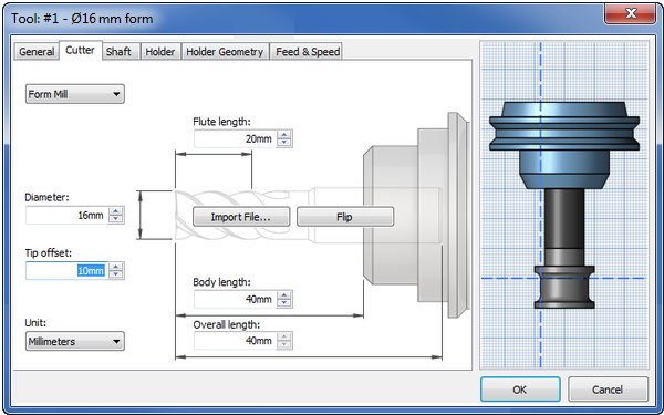

  5. Open the Inventor HSM Tool Library.
  6. Create a new mill tool by clicking the New Mill Tool button.
  7. Click the Cutter tab and choose Form Mill from the Type: drop down menu.
  8. Click Import File...
  9. Browse to and select the tool file you saved before. The sketch profile is loaded as the profile for the form mill, and previewed as shown here.
The Form Mill dialog box with preview
Using the tool is done similarly to all other tools, keeping in mind that the toolpath is created in relation to the compensation point defined by the diameter and tip offset.
