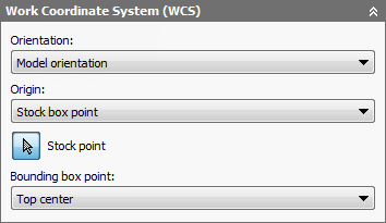

Work Coordinate System (WCS)
The Work Coordinate System (WCS) specifies the global coordinate system in which the post processed toolpath is output. The WCS defaults to the model orientation.
When editing and simulating, the coordinates are also presented in the WCS by default.
Orientation:
The Orientation: drop-down menu provides the following options to define the setup orientation of the X, Y, and Z WCS axes:
Origin:
The Origin: drop-down menu offers the following options for locating the WCS origin:
The Origin mini-toolbar displays automatically when Setup is invoked and offers an alternative to the dialog box for WCS origin selection.
The Origin mini-toolbar drop-down menu. Click the Undo button to the right of the drop-down to reselect the WCS origin.
Orientation & Origin
Coordinate System
Bounding box point:
When either the Stock box point or Model box point origin options are selected, you can then use the Bounding box point: drop-down menu to specify a point on the bounding box to locate the WCS origin.
Bounding box points

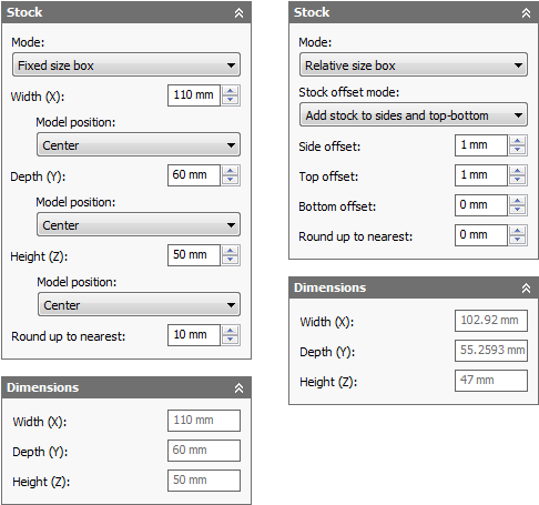

Fixed Size Box Mode
The Fixed size box mode lets you enter precise XYZ values to specify the width, depth, and height dimensions of your stock. You can also offset the left and right sides, the back and front sides, and the top and bottom of the stock to better position your model. You are presented with the following options:
  • Width (X): - Enter a value to specify the stock width.
  • Model position: Offset from left side (-X) - Specifies the offset of the stock in the negative X direction.
  • Model position: Center - The model is centered along the X axis within the stock.
  • Model position: Offset from right side (+X) - Specifies the offset of the stock in the positive X direction.
  • Depth (Y): - Enter a value to specify the stock depth.
  • Model position: Offset from back side (+Y) - Specifies the offset of the stock in the positive Y direction.
  • Model position: Center - The model is centered along the Y axis within the stock.
  • Model position: Offset from front side (-Y) - Specifies the offset of the stock in the negative Y direction.
  • Height (Z): - Enter a value to specify the stock height.
  • Model position: Offset from top (+Z) - Specifies the offset of the stock in the positive Z direction.
  • Model position: Center - The model is centered along the Z axis within the stock.
  • Model position: Offset from bottom (-Z) - Specifies the offset of the stock in the negative Z direction.
  • Round up to nearest: - Specifies the rounding increment for the stock size.
Relative Size Box Mode
Selecting the Relative size box mode provides options to add stock to the top, bottom, and/or sides of the stock.
No additional stock
No additional stock - No offset values are added to the stock size.
Add stock to sides and top-bottom
Add stock to sides and top-bottom - Symmetrical stock offset for all sides. Unique values for top and bottom offsets.
  • Side offset: - Specifies the additional stock on the sides.
  • Top offset: - Specifies the additional stock on the top.
  • Bottom offset: - Specifies the additional stock on the bottom.
Add stock to all sides
Add stock to all sides - Unique values for all offset directions.
  • Stock -X offset: - Specifies the offset of the stock in the negative X direction.
  • Stock +X offset:: - Specifies the offset of the stock in the positive X direction.
  • Stock -Y offset: - Specifies the offset of the stock in the negative Y direction.
  • Stock +Y offset: - Specifies the offset of the stock in the positive Y direction.
  • Stock -Z offset: - Specifies the offset of the stock in the negative Z direction.
  • Stock +Z offset: - Specifies the offset of the stock in the positive Z direction.

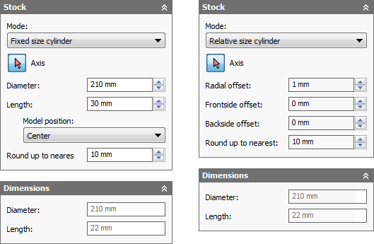

Fixed Size Cylinder Mode
The Fixed size cylinder mode lets you specify the axis of the cylindrical stock. You can also enter precise values to specify the diameter and length of the stock. The Model position: drop-down menu offers options to help you better position your model relative to the stock.
Tip: This stock mode is helpful when working with bar stock that is ordered at a given diameter or radius.
Relative Size Cylinder Mode
Like the Fixed size cylinder mode, the Relative size cylinder mode also lets you specify the axis of the cylindrical stock. In addition, you can specify radial, frontside, and backside offset values to better position your model relative to the stock.

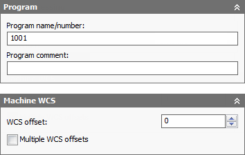

Post processing parameters like the program name or number, program comment, and work offset can be provided on the Post Process tab
The work offset is mapped by the post processor configuration to the corresponding zero table index (e.g. G54-G59) on the CNC control. A value of 1 would normally be setup to be the first available zero index on the CNC control (e.g. G54). The WCS and work offset are generally setup to match one another on a one-to-one basis.
Program name/number
Specifies the program name or number. This parameter is made available to the post processor.
Program comment
 Specifies the program comment. This parameter is made available to the post processor.
WCS offset:
Identifies the desired workpiece coordinate system (WCS) for the setup. It is the responsibility of the post processor configuration to map this number to the actual WCS on the machine.

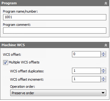

Multiple WCS offsets
Enable this check box to specify that the workpiece is to be duplicated.
WCS offset duplicates:
Specifies the number of workpiece duplicates. This is the total number of instances.
WCS offset increment:
Specifies the work offset increment used for workpiece duplication.
Operation order:
Specifies the ordering of the individual operations.
Using Multiple Setup Work Offsets
Inventor HSM supports patterning of entire setups using the Multiple WCS offsets feature, which essentially duplicates entire setups using different work offsets. This feature is generally used when the individual position of each instance is not precisely known.
Once you enable Multiple WCS offsets, you can specify the total number of instances and the work offset increment to be used. You can also choose the order of the duplicated toolpath (by setup, by operation, or by tool).
Enabling multiple work offsets
The setting for the WCS offset field depends on the post processor. In this case we are using a Fanuc post, so specifying 1 will use the first work offset (G54), the next field is the number of duplications, in this case 4, and the last is the increment, in this case 1, i.e. the next offsets will be G55, G56 and G57.

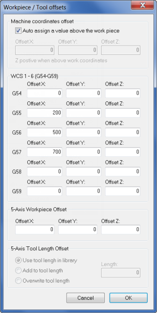

Using Backplot to Set Workpiece/Tool Offsets
The Multiple WCS offsets feature only applies to the post processing and setup sheet features. It is not possible to simulate the duplicated toolpath as the relative positions of each instance are not known inside Inventor HSM (e.g. G54 in relation to G55). So to see the multiple work offsets we must look at the posted file in Inventor HSM Edit.
Within the editor, we set the work offsets by first clicking Backplot tab File panel Backplot Window on the ribbon, and then clicking Backplot tab Other panel Set Workpiece/Tool Offsets to display the Workpiece/Tool offsets dialog box.
Setting work offsets in Inventor HSM Edit
Multiple work offsets in the posted file
