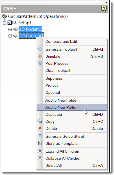

To create a new toolpath pattern you first need to select the operations to be patterned/duplicated from the CAM Browser, and then right-click and select Add to New Pattern from the pop-up context menu.
Selecting Add to New Pattern
This creates a new folder containing the selected operations and then creates the pattern in that folder.

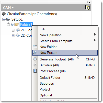

If you already have the operations to pattern in a folder, you can right-click on the folder and choose New Pattern instead.
Adding a pattern to an existing folder

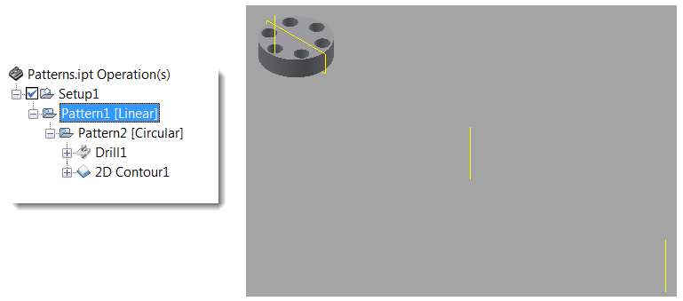

Patterns can be nested by putting the patterns into other pattern folders. However, be aware of the following two limitations when previewing a pattern:
  1. Only the first operation is previewed when previewing a pattern comprised of multiple operations.
  2. When previewing nested patterns, only the topmost pattern is previewed with the first operation.
In the example shown below, Pattern2 (a circular pattern) is nested within Pattern1 (a linear pattern), but is not visible in the Pattern1 preview. Observe also that Drill1 is only shown as part of the linear pattern.

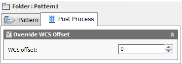

Regardless of the pattern type, and before finishing the pattern operation, be sure to click the Post Process tab in the Operation dialog box to access the Override WCS Offset check box.
Enabling this check box and entering the WCS offset number overrides the WCS offset defined in the setup for all the toolpaths within the pattern folder.
