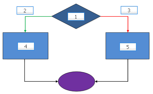

If-Then-Else statement in iLogic
In the If-Then-Else statement, one set of actions executes if a condition is true, and another set of actions executes if the condition is false:
(1) Condition (2) True (3) False (4) If condition is true, execute these statements (5) If condition is false, execute these statements
After the true or false statements execute, program control resumes with the next statement.
In iLogic, you can use the block or multi-line form to implement the If-Then-Else structure.
For example:
If size = “small” Then
length = 6.0
Else
length = 12
End If
If the conditional expression is true, the statements between the keywords Then and Else are executed. The statements between the keywords Else and End If are bypassed. If the conditional expression is false, the statements between the keywords Else and End If are executed. The statements between the keywords Then and Else are bypassed. In any case, program control resumes with the statement following the End If statement.

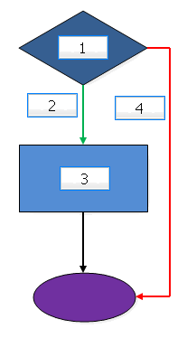

If-Then statement in iLogic
In an If-Then-Else statement, action is taken regardless of whether the condition is true or false. However, sometimes you perform an action or set of actions only if a condition is true, but perform no action if the condition is false:
(1) Condition (2) True (3) If condition is true, execute these statements (4) False
You can omit the Else portion of the block If structure. For example:
length = 6.0
End If

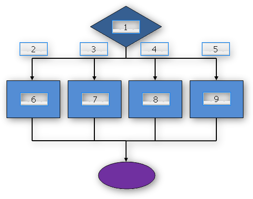

Case structure in conditional statements in iLogic
The case structure lets you choose between more than two alternatives:
(1) Case of Shift Code (2) Case “1” (3) Case “2” (4) Case “3” (5) Case Else (6) What to do when Shift Code=”1” (7) What to do when Shift Code=”2” (8) What to do when Shift Code=”3” (9) What to do when Shift Code is not “1”, “2”, or “3”
Case structure can be implemented using an extended block If structure or the Select Case statement structure.
