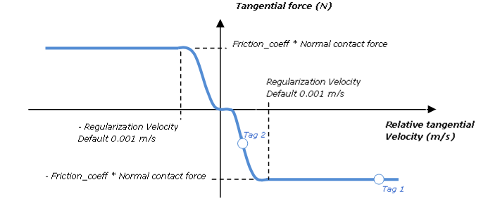

Regularization Velocity
In 2D contacts, a real non-linear Coulomb friction law is used. In joints and 3D contacts, for simplicity and to avoid a hyperstatic condition, a regularized Coulomb law is used, and can be illustrated as follows:
Regularization is driven by the velocity regularization parameter.
Using this model, in cases of sticking contact (or rolling contact), when the relative tangential velocity equals zero, the tangential force is null.
In the case of joint friction in a rotational degree of freedom, the tangential force is replaced by a tangential torque (unit: Nm) and the tangential relative velocity is a rotational velocity (unit: rad/s), both are calculated by multiplying the tangential force and dividing the translational velocity by the joint radius.
Example 1
A pin joint with a radius of 10 mm is piloted with a constant velocity “w” equal to 10 rad/s. We apply a force (Fn) equal to 20 N to the joint, perpendicular to its rotation axis, and the friction coefficient (mu) is set to 0.1.
In this case, the friction torque (Uf) in the joint can be calculated as follows:
? = r * w = 0.01 * 10 = 0.1 m/s
? > regularization velocity = 0.001 m/s => Uf = -mu * r * Fn = -0.1 * 0.01 * 20 = -0.02 Nm
See “tag 1” in the regularized Coulomb graph.
Example 2
Using the same example, but with a velocity (w) of 0.05 rad/s, the friction torque (Uf) is then given by:
? = r * w = 0.01 * 0.05 = 0.0005 m/sm
? > regularization velocity = 0.001 m/s => Uf ≈ -mu * r * Fn/2 = -0.1 * 0.01 * 20/2 = -0.01 Nm
See “tag 2” in the regularized Coulomb graph.
