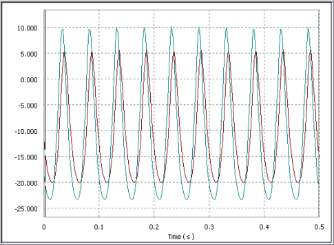

- Click Add Trace. The dialog box displays and the Origin selector is actively awaiting an input. Select the point at the end of the saw blade.
- In the dialog box, check the Output trace value option.
- Specify two additional trace points along the saw blade. Export the trace.
Set trace as reference
- In the Output Grapher browser, expand Traces.
- Expand Trace:1, and then Positions.
- Right-click P[X] and then click Set as Reference.
- Using the Output Grapher, Save command, save the Simulation.
- Enter the name Reciprocating Saw cam1.iaa. Click OK.
- Close the Output Grapher.

- in the Simulation Player, Click Run.
- Start the Output Grapher.
- In the Output Grapher toolbar, click Import Simulation.
- Select the file Reciprocating Saw cam1.iaa. The simulation data populates the Output Grapher browser.
- Expand the Reciprocating Saw cam1.iaa node and then expand Traces.
- Expand Trace:1 and then expand Positions.
- Click P[Z] to display it over the other simulations Trace. You can compare simulation results in this way.
