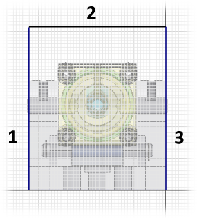

  5. Paying attention to the vertical and horizontal constraint indications, place three line segments: vertical, then horizontal, and then vertical again. Beginning the new segment from the end point of the previous segment ensures that the lines form a single, continuous open profile. Your profile should appear as in the following image:
    Note: To determine the horizontal endpoint on the right end of segment 2, drag your cursor down to locate the right end point of the construction line that you projected earlier and then move your cursor upwards vertically maintaining that alignment. The lower endpoint of segment 3 should be coincident with the right endpoint of the projected construction line.
    These three lines represent the inside faces of the Contour Flange that creates the base feature of the sheet metal guard.
