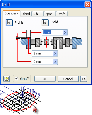

  4. On the grill sketch, select the large outer ellipse to satisfy the Profile selection in the Boundary tab. Accept the default settings for size.

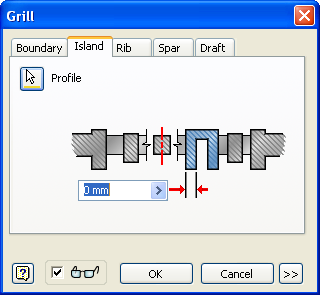

  5. Select the Island tab and then select the small center ellipse to satisfy the Profile selection. Accept the default of 0-mm.

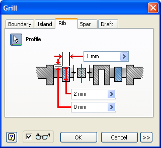

  6. Select the Rib tab and then select all the remaining line geometry to satisfy the rib selection. Accept the size defaults.
