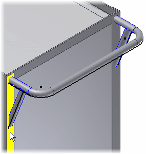

Next, we trim the round tubing.
- On the ribbon, click Design tab
Frame panel
Trim/Extend
- Select the four tubes, as shown.
- In the Trim - Extend To Face dialog box, click the Face command, and then select the face as shown.
- Click OK. The tubes are trimmed to the selected face.
