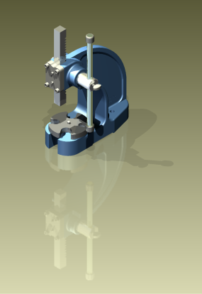

- On the ribbon, click Render tab
Render panel
Render Image .
- Ensure that Current View is selected on the Camera menu.
Note: Because the aspect ratio of your current window may not agree with the aspect ratio defined for your rendering, Autodesk Inventor draws a rectangle in the graphics window showing the area to be rendered. You can adjust your view before creating your rendering.
- Ensure Table Top is selected on the Lighting Style menu.
- Click Render. The program renders the model according to the chosen styles and the size of the model relative to the render area.
When rendering finishes, close the Render Output window.
