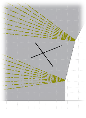

- Sketch two straight lines as shown:
Note: In this example, the size and position are not critical so dimensions will not be applied. In your designs, you will likely want to apply dimensions to position these lines accurately.
