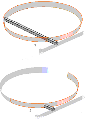

Notice that the strap surface feature is a single 180-degree revolved surface that matches the outer surface of the strap. The support tube profile will be extruded to this surface. If the termination surface provides more than one solution, the maximum termination is always the result. See the following image for an example.
You can choose a minimum or maximum solution for an extrusion termination.
1 - Extrude to 360 degree extrude strap
2 - Extrude to 180 degree extrude strap
