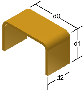

Parameters and take note of d0 (part width), d1 (height), and d2 (length).
- For clarity, rename the parameters. In the Parameter Name column, click d0 and enter a more descriptive name such as channel_width.
- Rename d1 to channel_height and d2 to channel_length.
- Click Done to accept the name changes and close the Parameters dialog box.
