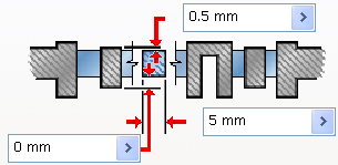

  5. Activate the Spar tab and then select the arcs.
    • Top Offset = 0.5 mm
    • Thickness = 5 mm
    • Bottom Offset = 0 mm
