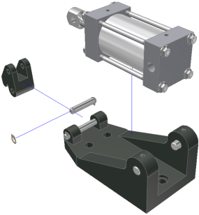

Create exploded views in Autodesk Inventor drawings with presentation files.

The assembly explosions you create within Inventor Studio cannot be placed as drawing views in IDW or DWG drawing files. Use presentations instead.
To begin, you open the supplied Cylinder Clamp dataset, and create a presentation file from the default (mm) template.
