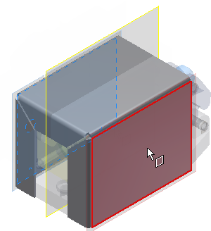

Plane and select Midplane between Two Parallel Planes from the drop-down menu.
- In the graphics window, click the outside face shown in the following illustration:
- Now, rotate the view and click the outside face on the opposite side. The new work plane is created midplane between the two outside faces.
