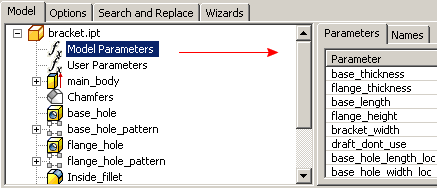

  3. Select the Model tab. The top left panel of this window includes a view of the Model tree. Click the Model Parameters node in the tree. Notice that the top right panel now lists only the Model parameters.
    To see other sets of parameters, you can click the User Parameters node in the model tree to display only the manually created parameters.

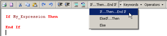

    You write rules in the rule text area, which is located in the bottom panel of the Edit Rule dialog box. You can enter Rule keywords by typing them directly into the text entry field. Or, you can select generic statements from the toolbar above the field and then edit the statements.
    This tutorial describes entering the statements manually, unless otherwise indicated.

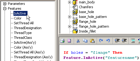

  1. In the Snippets area on the left side of the editor, click the System tab. Expand the Features node, then double-click the IsActive choice to insert its text into the rule editor.

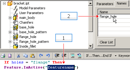

  2. Click the Model tab at the top of the Edit Rule dialog box, and click flange_hole in the Model tree.
  3. Click the Names tab in the top right corner of the dialog box, and notice that flange_hole now appears here.
  4. Highlight featurename in the rule text, and then double-click flange_hole in the Names tab to replace featurename with flange_hole.
    (1) Highlight generic text. (2) Double-click name to replace highlighted text.
