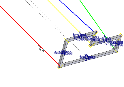

- Select Frame.iam in the Select Source Assembly dialog box. Click Open. The Constrain iCopy dialog box displays.

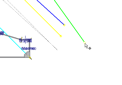

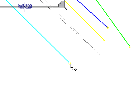

- Select the work point at the end of the cyan (light blue) line for the Lower left point.
- Select the work point at the end of the green line for the Lower right point.
- Select the work point at the end of the blue line for the Upper left point.
- Select the work point at the end of the yellow spline for the Upper right point.
- In the Frame Height field, enter 125 mm.
- In the Frame Width field, and enter 125 mm.

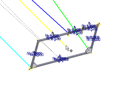

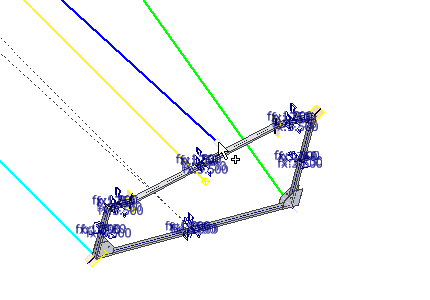

The frame parts are copied for each iCopy result. Each iCopy result uses the plate part.
- The iCopy results are created as shown. If the iCopy is not successful, return to the iCopy template and review the steps to create it.
Note: If your assembly does not appear as shown in the following image, click the
Local Update button on the
Manage tab to update the iCopy results.
