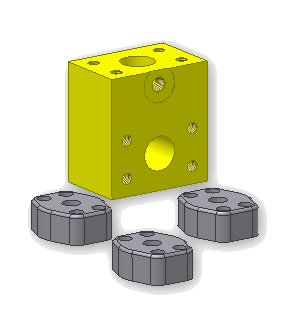

- Use Orbit to orient the manifold block as shown.

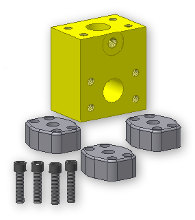

In addition to the block, this assembly includes three union caps and three sets of screws to attach the caps.
- Select the Place command again, and double-click union_cap.ipt.
A copy of the component becomes attached to the mouse pointer. and the Place Standard iPart dialog box is displayed.
- Click the Table tab, and select iPart member Union-01 (Part Number U-050).
- Click in the graphics window to place a copy of the union cap near the manifold block. Click two more times to add a total of three union caps, then click Dismiss to close the dialog box.
Now you can add the screw components.
- Select the Place command again, and double-click Screw.ipt.
- In the Place Standard iPart dialog box, select iPart member Screw-01. Place four Screws in the graphics window, and then click Dismiss to close the dialog box.
- Save your assembly as my_manifold_block.iam.
