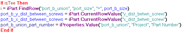

  5. For instances in which we are using Port B, add a section that sets the port size, screw pattern parameter values, and port_b_union part number.
    Copy Code Block
    if isTee Then
    i = iPart.FindRow("port_b_union", "port_size", "=", port_b_size)
    port_b_y_dist_between_screws = iPart.CurrentRowValue("y_dist_betwn_screw")
    port_b_x_dist_between_screws = iPart.CurrentRowValue("x_dist_betwn_screw")
    port_b_union_part_number = iProperties.Value("port_b_union", "Project", "Part Number")
    End If
    We enclosed this entire block in an If isTee statement, so that these lines are only processed for a tee-style manifold block. The statement If isTee Then is equivalent to If isTee = True Then, but it provides a more concise expression format.
    We first choose the appropriate row in the s iPart table of the union part, corresponding to the value of the port_b_size parameter, and then extract the values to use for the x and y pattern offsets. Then, we extract the Part Number from the union part, and store its value in another parameter for later reference.

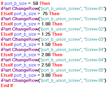

  6. For the last part of this rule, we choose the member within the s iPart table of the screw part to use for Port B. It is based on the value of the port_b_size parameter. Use a series of If/Then/Else statements to control it.
    Copy Code Block
    If port_b_size = .50 then
    iPart.ChangeRow("port_b_union_screw", "Screw-01")
    elseif port_b_size = .75 then
    iPart.ChangeRow("port_b_union_screw", "Screw-02")
    elseif port_b_size = 1.00 then
    elseif port_b_size = 1.25 then
    iPart.ChangeRow("port_b_union_screw", "Screw-03")
    elseif port_b_size = 1.50 then
    iPart.ChangeRow("port_b_union_screw", "Screw-04")
    elseif port_b_size = 2.00 then
    elseif port_b_size = 2.50 then
    iPart.ChangeRow("port_b_union_screw", "Screw-05")
    elseif port_b_size = 3.00 then
    iPart.ChangeRow("port_b_union_screw", "Screw-06")
    End If
  7. Click OK to close the dialog box and save the rule.

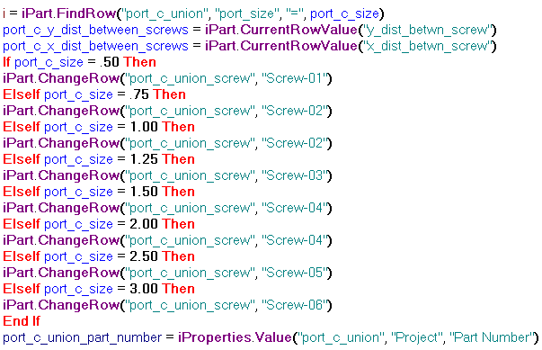

Add port_c_rule
The rule for Port C is almost the same as for Port A, except that everything referencing Port A must reference Port C instead.
  1. Open the Rule Browser.
  2. Double click port_a_rule.
  3. Use the mouse to highlight the entire rule.
  4. Press Ctrl+C to copy the rule text.
  5. Click OK on the Edit Rule dialog box to close it.
  6. Add a new rule named port_c_rule.
  7. In the Edit Rule dialog box, click in the rule text area, and press Ctrl+V to paste the rule.
  8. Click the Search and Replace tab at the top of the dialog box.
  9. Enter port_a in Find what.
  10. Enter port_c in Replace with.
  11. Place a check mark in Match Case.
  12. Click Replace All in This Rule.
    Copy Code Block
    i = iPart.FindRow("port_c_union", "port_size", "=", port_c_size)
    port_c_y_dist_between_screws = iPart.CurrentRowValue("y_dist_betwn_screw")
    port_c_x_dist_between_screws = iPart.CurrentRowValue("x_dist_betwn_screw")
    If port_c_size = .50 then
    iPart.ChangeRow("port_c_union_screw", "Screw-01")
    elseif port_c_size = .75 then
    iPart.ChangeRow("port_c_union_screw", "Screw-02")
    elseif port_c_size = 1.00 then
    elseif port_c_size = 1.25 then
    iPart.ChangeRow("port_c_union_screw", "Screw-03")
    elseif port_c_size = 1.50 then
    iPart.ChangeRow("port_c_union_screw", "Screw-04")
    elseif port_c_size = 2.00 then
    iPart.ChangeRow("port_c_union_screw" "Screw-04")
    elseif port_c_size = 2.50 then
    iPart.ChangeRow("port_c_union_screw", "Screw-05")
    elseif port_c_size = 3.00 then
    iPart.ChangeRow("port_c_union_screw", "Screw-06")
    End If
    port_c_union_part_number = iProperties.Value("port_c_union", "Project", "Part Number")
  13. Click OK to close the dialog box.
  14. Save your assembly file.
