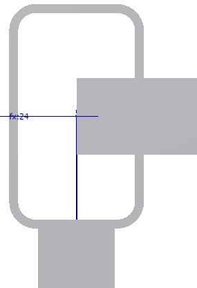

Next, we remove the excess material from the lower c-channels.
- Orient the model view as shown.
Note: The visibility of the tube in the background has been turned off for clarity.

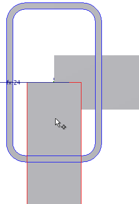

- First, select the trimming component, which is the tube.
- Select the component to trim, which is the c-channel.

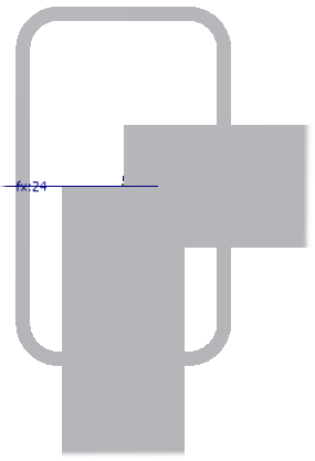

- Click Apply.
- Use the same method to trim the other c-channel.
You can repeat these steps to trim the c-channels at the other three junctions, but it is not required for this exercise.
