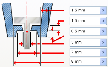

  5. On the Head tab:
    • For Wall Thickness, enter 1.5 mm.
    • For Shank Height, enter 1.5 mm.
    • For Clamp Height, enter 0.5 mm.
    • For Shank Diameter, enter 3 mm.
    • For Clamp Diameter, enter 7 mm.
    • For Head Diameter, enter 8 mm.
    • For Draft Options, enter 2.5 deg in each field.
    • Select the Counterbore type.

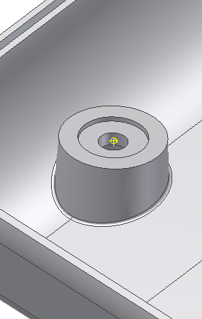

  7. Click OK to create the four bosses.

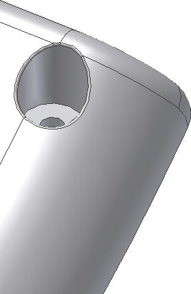

  8. Rotate the body to see the recess for the screw head.

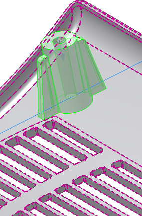

    The following image shows a cutaway view of a boss.
