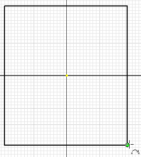

- Sketch a rectangle approximately 10 inches square. The exact size and shape is not important.
- Click the Finish Sketch command on the ribbon, or right-click and select Finish 2D Sketch from the marking menu to exit the sketch.
