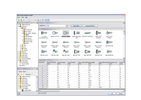

The Place from Content Center dialog box is the main interface for a Content Center consumer. You can find, select, and place a standard part or feature to an assembly. The dialog box presents a merged view of content contained in all configured libraries.
The Place from Content Center dialog box displays several panels:
- Category View panel on the left displays a tree structure of the current Content Center database.
- List View panel on the right displays all items available in a category (folder) selected on the Category View panel.
- Table View panel displays all members of a part (feature) family selected on the List View panel.
- Search panel enables you to find components in libraries.
- Favorites panel stores your favorite parts.
- History panel displays previously placed components.
