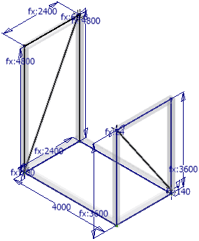

The frame components are associative to the skeletal sketches. We modify the sketches in frame_generator.ipt to see how this change affects the frame members.
- Edit frame_generator:1.
- On the ribbon, click Manage tab
Parameters panel
Parameters
- Change the value for base_L to 3000 mm.
- Click Done.
- Return to the assembly. The frame components, including the various joints and cuts, update to match the change.
