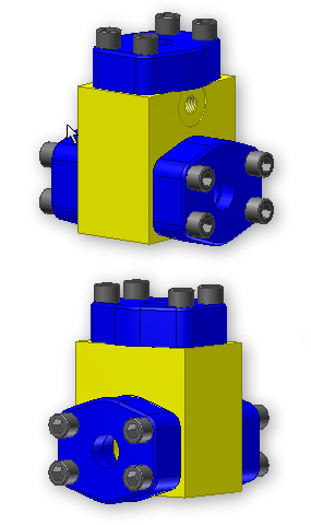

- Repeat the previous steps for port_b_union_screw and port_c_union_screw. Remember to rename the patterns when you are done. Your model should look as shown in these front and back views.
- Save your assembly file.
