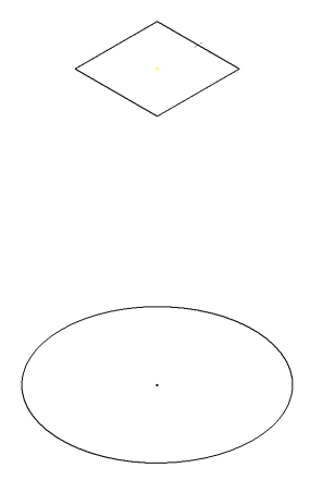

- Hide the work plane that you created and the XY origin plane (if displayed). Hide the dimensions on both Sketch1 and Sketch2. Your model should appear as shown in the following image from the default Home View (F6).
