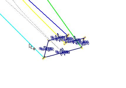

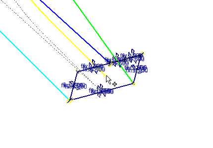

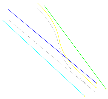

- Select the work point at the end of the cyan (light blue) line for the Lower left point.
- Select the work point at the end of the green line for the Lower right point.

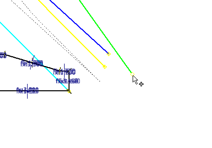

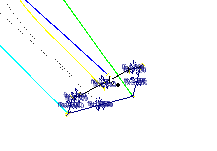

- Select the work point at the end of the blue line for the Upper left point.
- Select the work point at the end of the yellow spline for the Upper right point.

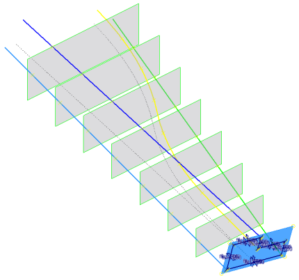

- Select the Path pattern tab to specify path information.
- Select the cyan (light blue) line to use as the path for the pattern (the Path button is selected automatically). The Work Plane is selected automatically based on the selected path.
- Enter 8 in the Instance number field.
- Enter 2500 mm in the Offset field.

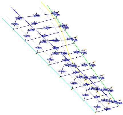

- Click OK to complete the command. The iCopy results are created as shown. If the iCopy is not successful, return to the iCopy template and review the steps to create it.
