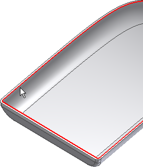

We will now build a lip-groove combination to facilitate placing the mating parts in a physical assembly. Orient the view to the inside of the part like the following image.
  1. On the ribbon, click 3D Model tab Show Panel icon . Select Plastic Part panel to display the Plastic Part panel, and then select Lip.
  2. Make sure the Lip button is selected in the dialog box.
  3. On the Shape tab:
    • Select the inside edge as the Path Edges.
    • Leave the Path Extents unchecked.
    • Click the Pull Direction check box.
    • Select the Y Axis in the Origin folder as the pulling direction.
