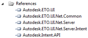

You implement Actions in a class library. There can be multiple class libraries, each with multiple actions. Each class within an assembly that inherits from ServerIntentActionBase is loaded into the Intent session as an action at runtime. This class requires some references from the \Inventor ETO Components 2014\Bin\Public Assemblies\ directory. In addition, reference the IntentAPI assembly from the \Inventor ETO Components 2014\Bin\ directory if needed.
Additionally, include each action name in an Actions list rule on the root part (or the part in which to run the action in the context of). For example:
