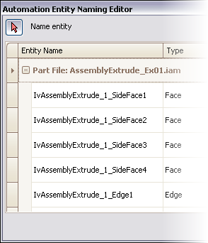

There is an automatic entity naming mechanism for IvAssemblyExtrudeFeature. The illustration shows the automatically-applied entity names as viewed in the Entity Naming Editor.

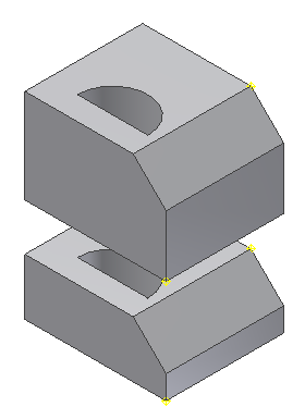

This example shows a "Through-All" type of extrusion. Extrude_HalfCircle_1 is a sketch part used to define the extrude profile.

This example shows an extrusion which terminates at a workplane. Extrude_HalfCircle_1 is a sketch part used to define the extrude profile. The illustration shows a cutaway view that displays the profile of the extrusion.
