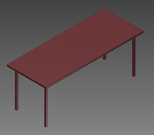

The TableTop design is simply a rectangular block that has a length, width, thickness, and PaintColor. These are all parameters on the design and use the standard structure as described above.
Parameter Rule dvLength As Number = 60.0 Rule Length As Number = dvLength Parameter Rule dvWidth As Number = 24.0 Rule Width As Number = dvWidth Parameter Rule dvThickness As Number = 1.0 Rule Thickness As Number = dvThickness Parameter Rule dvPaintColor As String = "Brown" Rule PaintColor As String = dvPaintColor
The TableTopGraphics design mixes in Block and simply overrides the rule for the block's Height to be the table top's thickness.
Rule Height As Number = Thickness
The Leg design is also a simple rectangular block. However, it only has Width, Height, and PaintColor.
Parameter Rule dvWidth As Number = 1.0 Rule Width As Number = dvWidth Parameter Rule dvHeight As Number = 24.0 Rule Height As Number = dvHeight Parameter Rule dvPaintColor As String = "Brown" Rule PaintColor As String = dvPaintColor
The LegGraphics design also mixes in Block, but it overrides the rule for the block's Length to be the Leg's Width. This is done because we want our legs to be square.
Rule Length As Number = Width
The table assembly contains a table top and four legs. It also contains the top level parameters for the entire model, such as the total height of the table, its length and width, and the PaintColor.
Parameter Rule dvHeight As Number = 24 Rule Height As Number = dvHeight Parameter Rule dvLength As Number = 60 Rule Length As Number = dvLength Parameter Rule dvWidth As Number = 24 Rule Width As Number = dvWidth Parameter Rule dvPaintColor As String = "Brown" Rule PaintColor As String = dvPaintColor
The table top will get its default values for the length, width, and PaintColor passed into it from the table assembly. Likewise, the legs each get their default values for their height and PaintColor from the table assembly.
Child TableTop As :TableTop
dvLength = length
dvWidth = Width
dvPaintColor = PaintColor
End Child
Child Leg As :Leg, Quantity = 4
dvHeight = LegHeight
End Child
The Inventor version of the TableGraphics design mixes in ivAssemblyDocument since the Table is the Root part, and therefore must be an assembly. When this is ported to the Silverlight host, the TableGraphics will mix in BasePart instead of ivAssemblyDocument.
