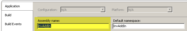

    In Assembly name, the attribute of the assemblyIdentity element is the name of the assembly, as highlighted in the following image.

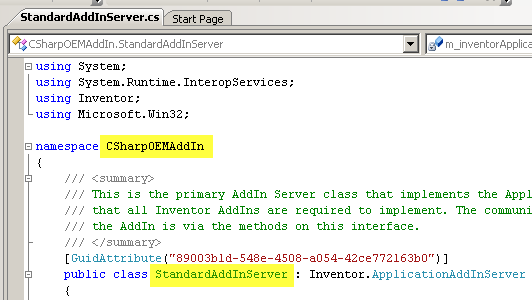

    The "name" attribute of the clrClass element consists of two parts, separated by periods. The first is the name of the namespace that the COM class is defined within. For this example is it CSharpOEMAddIn, and the second part is the name of the class that implements the ApplicationAddInServer interface, which is "StandardAddInServer". Both are highlighted in the following image.

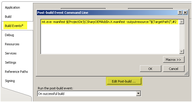

  3. Add a post-build process to incorporate this manifest into your .dll. The post-build process calls mt.exe, which is a Microsoft utility that embeds the manifest into the dll of your add-in. In the Application Properties dialog box, Build Events tab, click Edit Post-build…
  4. . In the Post-build Event Command Line dialog box, enter the following string. Replace InvAddin with the name of your add-in.
    call "%VS90COMNTOOLS%vsvars32"
    mt.exe -manifest $(ProjectDir)\InvAddin.X.manifest -outputresource:"$(TargetPath)";#2
  5. Remove any code associated with registering the add-in in the registry by removing the Register and Unregister methods from your add-in class. The AddInGuid function is in the same region as the registration functions. If you plan use this property in other areas of your add-in, do not delete it.
  6. Compile your project. The manifest embeds within your .dll. If any errors occur during the compile, verify that the command string you entered matches the string in step 4.
