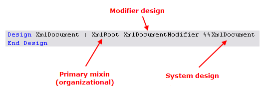

ETO provides modifier designs to enable you to alter the default behavior of system designs. The default modifier design is not editable. You must create a copy of it (identically-named) as a user design, which you can then edit. The modifier design name appears after the primary mixin in the design declaration, as the following example shows:
