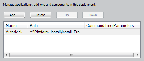

When you create a deployment, at the end of the product list in the installer you see an option to include additional software in your image.
This is used for installing language packs, components from apps.exchange.autodesk.com, or other third-party software. The additional software must be packaged in a self-extracting executable (.EXE) or .MSI format. This option should not be used to install Vault or other Autodesk products. When you choose this option, you use a table to manage the additional software.
Before creating a deployment, store any additional software in a single location that is easy to find. To add software to a deployment, click Add, browse to the file location, and then click the file. The file name and path are added to the management table. Buttons for deleting files and moving them up or down in the list become active when the table contains at least two files. Horizontal and vertical scroll bars are added when the table extends beyond the window.
