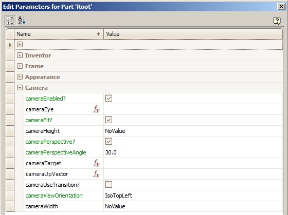

Example 1
The Camera parameters on an Assembly document are the same as the arguments to iv_setCamera().
