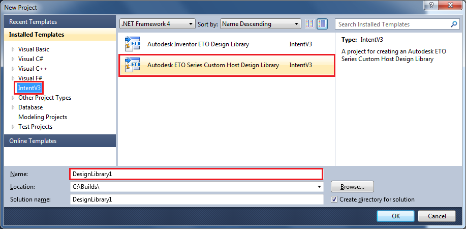

To get started, Launch Visual Studio and select File->New->Project from the menu. The New Project dialog is displayed and you should see an IntentV3 Section as shown below. Select the "Autodesk ETO Series Custom Host Design Library" template and give the project a name.
After you are satisfied with your selections, click OK to create the project. A new Visual Studio project is created. The project will have an empty root design and a file called IntentHost.config.
