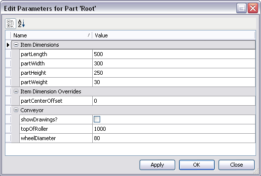

The next example shows the %%PartEditorCategories and %%PartEditorRules annotations.
<%%DisplayName ("Standard Conveyor System"), _
%%CategoryOrder ("Item Dimensions,Item Dimension Overrides,Drive,Drive Spec,Conveyor"), _
%%PartEditorCategories ("{Conveyor}"), _
%%PartEditorRules ("{partLength, partWidth, partHeight, partWeight, partCenterOffset}"), _
Design StdConveyorSystem : ConveyorRoot BOMMixin CustomerMixin IvAssemblyDocument
%%PartEditorCategories specifies the categories to be displayed in the Part Editor. However, if you have also specified %%PartEditorRules, then those rule are also displayed, regardless of whether they belong to a category specified in %%PartEditorCategories.
