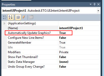

By default, the IntentUIProject does not cause graphics to update automatically when a change to the Intent model takes place. This behavior is to allow you to make a series of changes without waiting for time consuming graphics updates between each one. However, our sample project is simple enough that enabling automatic updates does not pose a significant performance cost. Go to the IntentUIProject that we added to our form and in the Properties, switch Automatically Update Graphics ? to True.

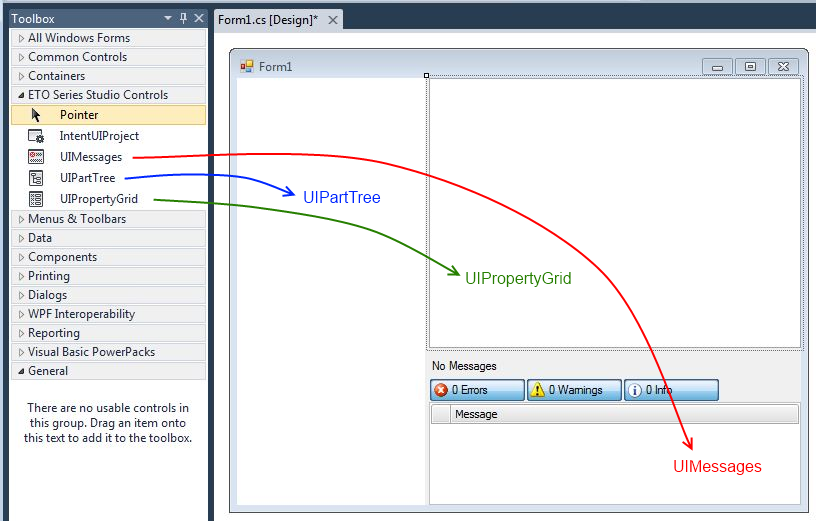

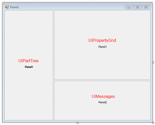

Before you add the remaining three controls to the UI, add a few SplitterPanels. Then you can easily position and resize them within the form. Our UIPartTree is on the left, and the UIPropertyGrid and UIMessages stack vertically on the right.
Now, drag the corresponding controls to their locations within the SplitterPanels, and then set their Dock properties to Fill.

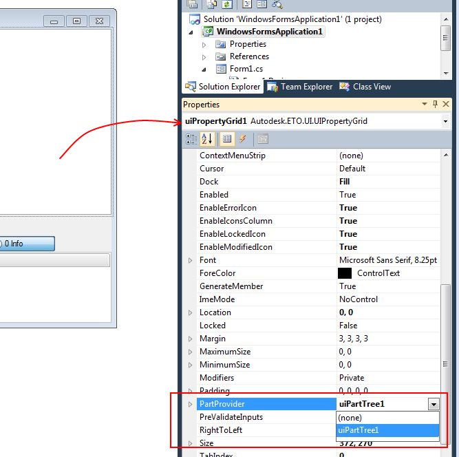

Now the controls are on the form where we want them. Next, wire them up to the IntentUIProject component we added originally. The simplest method is to set their PartProvider properties from within the Visual Studio designer. Set the part provider for the UIMessages control and the UIPropertyGrid control to the UIPartTree control:

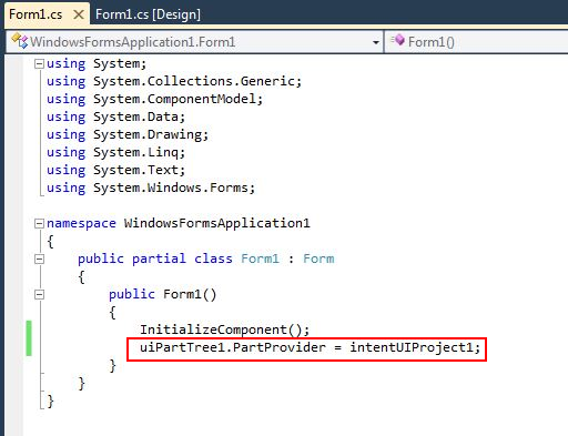

Set the part provider for the UIPartTree control to the UIProject control in code:

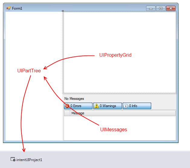

The following image shows the PartProvider relationships between the various controls in our UI.
The UIPropertyGrid and UIMessages both have their PartProvider properties set to the UIPartTree. The UIPartTree has its PartProvider set to the IntentUIProject.
